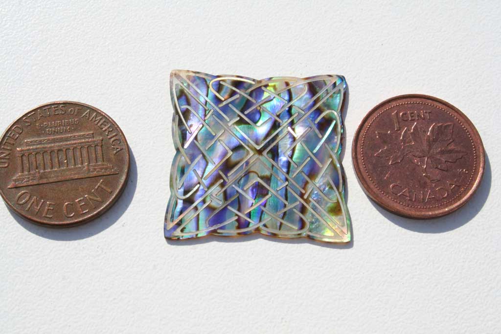

With some encouragement from The Duke himself, I decided to try and push the limits a bit with my inlay work. In the interest of fairness, I included pennies from both sides of the border.

The knot is abalone inlaid with gold MOP. The gold MOP strips are just under 0.014" thick.
It's really, really shiny so it was quite a hassle to get a picture where you could see all the details clearly. The photo's unedited, but the image compression took out a chunk of the colour from the abalone. That's about as close as I could get it to focus with the kit lens on my camera.

You know, I can visualize how you might be able to hold down a penny-sized piece of shell with a vacuum and cut the micro channels.
But, how in the world did you hold the shell to cut the gold MOP inlays??? The only way I can think of is that this piece is two layers: the gold MOP layer below is cut in relief so the "inlays" stick up proud of the surface, and the abalone is cut with channels that slide over the MOP. But you said "The gold MOP strips are just under 0.014" thick", so I must be wrong. However you did it, it is amazing.

I guess I should say 'wide'? The gold pearl and the abalone are both full-thickness (0.05"). The pearl is inlaid into the abalone in individual, tiny pieces.

I guess it was probably glued to a backer board with titebond or the like, then soaked in water to release it once cut Dennis. When making duplicate or mirrored pieces, I use titebond to glue two blank pieces together, cut and shape, then soak them - works great.

Tony's right that it's all glued to a backer board for the cutting, I forgot to mention that one. Guys use hide glue or CA.
